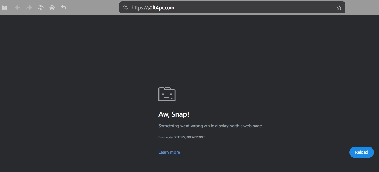

发表于 : 2023年 12月 22日 09:54
ttomomo
Updated to Ver:3.12.5
Some websites do not work (even in incognito mode).

Re: Ver:3.12.5. Some websites do not work.
发表于 : 2023年 12月 22日 13:40
The information displayed on the screenshot is an abnormal page crash! Can you try to open the website under new users?
发表于 : 2023年 12月 22日 14:12
ttomomo
No luck, still not work. Thanks.
发表于 : 2023年 12月 23日 05:29
ttomomo
After removing the line '--disable-direct-write' from the StartupParm.txt, the problem goes away. However the font rendering effect goes away too because the flag of disabling direct-write is no longer existing.
发表于 : 2023年 12月 23日 06:59
Confirming the issue and attempting to fix it!
