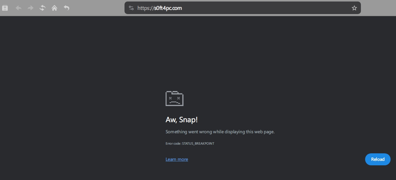

Some websites do not work (even in incognito mode).
Re: Ver:3.12.5. Some websites do not work.
Test normal
2023-12-22 104158.jpg (66 KiB) 查看 25537 次
The information displayed on the screenshot is an abnormal page crash! Can you try to open the website under new users?

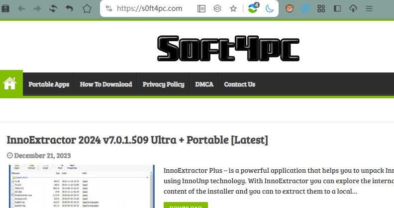

A brand new user environment?
In the state of not loading extensions or scripts。
What is the system?
ttomomo
帖子: 50
注册时间: 2022年 12月 28日 08:19
帖子 ttomomo »
I used a brand new portable version (3.12.5) and it works fine without any problem. However I still could not pinpoint which extension or script that caused the error of my installed version of Catsxp browser.
